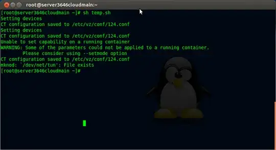

It turns out that you have to set up the tun/tap device on the openvz host. To do this you need to make sure the host is running with lsmod | grep tun. If nothing appears then run modprobe tun before running lsmod | grep tun to check it appears. Now that that is done you need to give the container access with the following commands (I suggest putting this in a script and then calling that):
CTID=YOUR_CONTAINERS_ID_HERE
vzctl set $CTID --devnodes net/tun:rw --save
vzctl set $CTID --devices c:10:200:rw --save
vzctl set $CTID --capability net_admin:on --save
vzctl exec $CTID mkdir -p /dev/net
vzctl exec $CTID mknod /dev/net/tun c 10 200
vzctl exec $CTID chmod 600 /dev/net/tun
I got a warning error message shown below, but restarting openVPN on the client now seemed to work.
