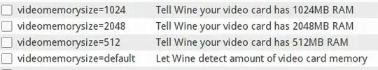

You can also use the gui version of winetricks from the applications menu and select the wineprefix and then select change settings. Other options available for setting video memory are:
There is no way to tell whether these settings will work with your system, and you may have to tweak other settings such as shaders, etc. I should refer to the wine appdb page and the winetricks wiki and wine FAQ. You may have to investigate how wine and wined3d is detecting your video card and its capabilities.
