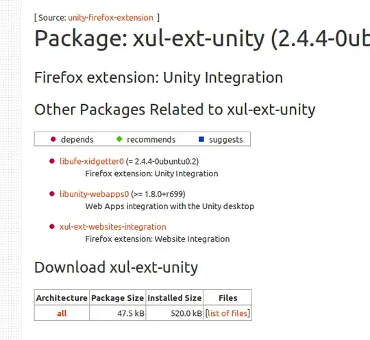

I cannot tell you how you do it for all packages, but here is a possible procedure for single packages.
Warning: The site I suggest to use does (strangely) not support https yet - so you cannot be certain that you are really talking to the correct site, which makes the check much less useful than expected - as Eliah Kagan pointed out in a comment.
  1. visit packages.ubuntu.com
  2. select your distro
  3. select "all packages" (down at the bottom)
  4. look into /var/cache/apt/archives and choose suspicious packages (for instance those with a recent date)
  5. run a sha256sum against that package
  6. choose that package on the website, you get enter image description here

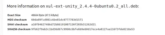

  7. click on the link beneath Architecture enter image description here
  8. compare the result from step 5 with the published value.
