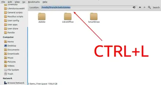

You can activate the "location" view with CTRL+L. To permanently show the path instead of "breadcrumbs" you will have to manually change a dconf key:
gsettings set org.gnome.nautilus.preferences always-use-location-entry true
To revert the changes simply execute the following command:
gsettings set org.gnome.nautilus.preferences always-use-location-entry false

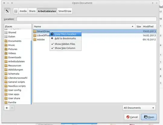

Copying file paths in the Save/Open dialog with Nautilus 3.4.2
As @AliNa pointed out, it used to be that you could access the location of a file or folder in the save/open dialog in the same manner as you can in a regular Nautilus window
This feature has been abolished in recent Nautilus releases as part of GNOME's design philosophy.
However, you can still access the file and directory paths from the context menu:
http://i.imgur.com/tvlBjum.png
It seems as though this method has been removed as well in more recent revisions of Nautilus (the ones that ship with Ubuntu >12.10)...
