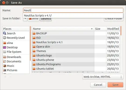

You can enter the subfolder name in the Name field and use Tab for autocomplete.

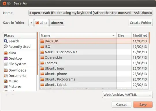

Or if you don’t know the subfolder names, you can use ↓ and ↑ arrow keys to put the focus out of Name field. Then you can use Tab to focus on folder field, and press Enter to open a folder.
