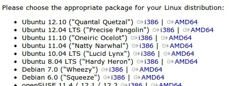

Now, in the case you have some update problems with Virtualbox, the easiest solution I have found is to download the latest version from the original site. You can find the latest Virtualbox version for Ubuntu in: https://www.virtualbox.org/wiki/Linux_Downloads
It should show the versions of Ubuntu like in the following image:
You can also find the latest Extension Pack in: https://www.virtualbox.org/wiki/Downloads
After you download the newest Virtualbox version, simply double click on it and the Ubuntu Software Center will take care of everything else. I should mention that you can only install the Extension Pack to the same version of Virtualbox. So if you have Virtualbox 4.2.10, you can only install the 4.2.10 of the Extension Pack.
