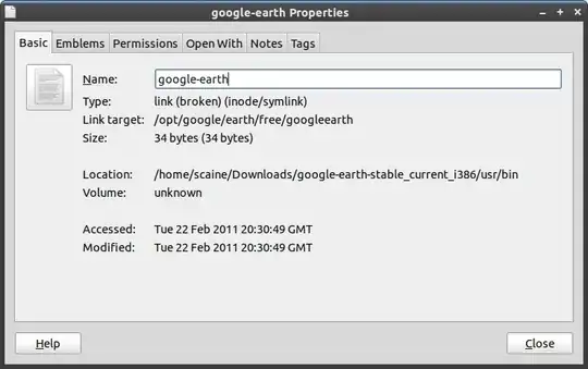

I downloaded the 32-bit version, then right clicked on it and choose "Extract Here" in nautilus. That shows me the folder structure that would be installed if I installed the deb file. It seems that the "googleearth-bin" file should be in /opt/google/earth/free.
I guess you'll need to check whether that exists on your system. If not, perhaps the binary install has changed the permissions on that file in a way that breaks overwriting from the deb? Not sure how that's possible given that you have to sudo to install a deb.
Google Earth file structure
It looks like the /usr/bin/googleearth is just a shortcut to that file too, not a script, so it's likely that there's something wrong in the /opt directory I mentioned above.
File properties
I guess you'll be best served by deleting the files/folders in the deb, then trying the re-install afresh?
