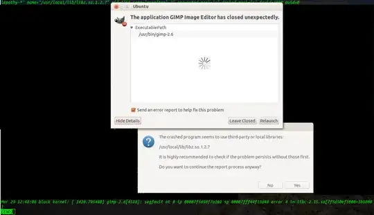

Sometimes different applications crash, and the system notifies me that the crashed application uses a third party library (libz) and suggests trying without it.
I can always reproduce it by exporting PNG file to JPEG format in Gimp:
(Full size screenshot)
When I first experienced the issue I had libz 1.2.5 installed in the system, then I updated it to 1.2.7, but the issue persists.
I don't know when and what this library was installed for.

Answering my question by myself.
I think that at the beginning my question was little misleading.
The system reported me that the crash could happen because of third party library used by Gimp (/usr/local/lib/libz.so.1.2.7).
I removed /usr/local/lib/libz.so.1 symlink to /usr/local/lib/libz.so.1.2.7 and traced with strace that default library is used
