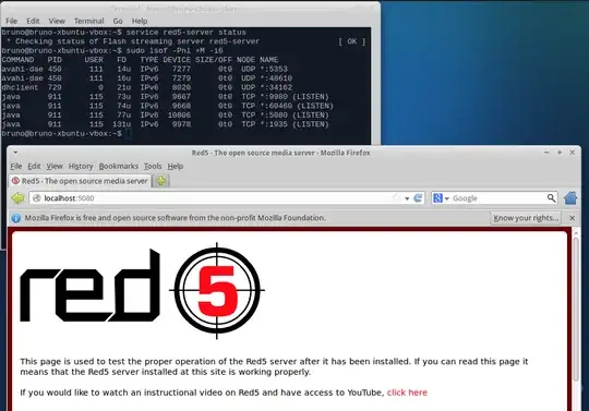

hey guise here is a follow up ok so I was able to reproduce same issue here (https://i.sstatic.net/Rz7lb.png)
"HTTP Status 404 - /vod/index.html
type Status report
message /vod/index.html
description The requested resource (/vod/index.html) is not available.
Apache Tomcat/6.0.35"
Just point out I recently did a fresh Install of "ubuntu-12.04.2-server-amd64" and then proceded to install "red5-server" Im able to open the localhost:5080 page but can not access the /demos or /installer as smart-ba describes...

after re-evaluation of this install I've noticed that on the localhost:5080 page under the HTTP Status 404 issue it has the following statement.
" "red5-server" package doesn't contains /demos or /installer webapps. Please note that /installer and /demos webapps are for demonstration purpose only and should never be installed on a public red5 server (no security at all in those applications)."
so just pointing out that this was properly installed as i just have done myself even tho u get the 404 error thats ok.
