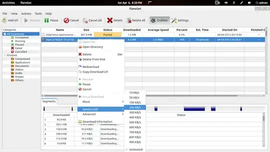

FlareGet 1.4-7 which is going to be released next week, supports all the features you need and even supports throttling of downloads. Here is the changelog
Here is the image, of the pre-release version showing speed limits: enter image description here
Try Flareget, it has all and has its own PPA.
