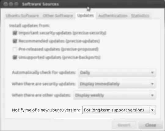

You need to change the update-manager settings to show 12.10, since it's not an LTS release, and by default update-manager only shows available LTS updates.
To do so, follow these steps:
- Open up
update-managerthrough theDash: tap on Windows and type inupdate-manager. - Click on
Settings. - Under the
Updatestab, changeNotify me of a new Ubuntu versionfrom the defaultFor long-term support versionstoFor any new version.
For clarity, here's a screenshot:
