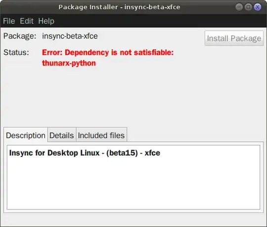

But I get this error:
How to solve this?
Installing the generic version works, but it also installs automatically Nautilus, which in Xfce starts taking over actions that otherwise should be reserved for Thunar. (I do not like to use Nautilus in Xfce - more here.)
I guess that is why an Xfce version exists in the first place. But I cannot find how to install thunarx-python.
The Quantal version of the missing dependency thunarx-python is to be found here.
(For other versions of Ubuntu look here.)
After installing it, Insync-Xfce can be installed and works fine, with Thunar as file manager.
