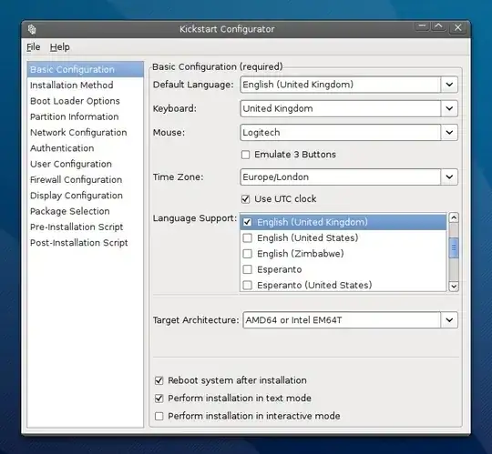

Having never done been in this predicament (I don't have hundreds of servers - I've always just used base images), I can only give you my gut instinct.
That aside, I would say netboot is probably your best bet. Create a master server, get it doing what you want and then have all your other machines boot and install from it. Scripting things to happen automatically (ala run-once) shouldn't be too hard. You do all the secondary things through kickstart.
More (although it's a little old): https://help.ubuntu.com/community/PXEInstallServer
Edit: There's an application called system-config-kickstart that should help make generating the kickstart file quite a bit easier. YMMV.
alt text
