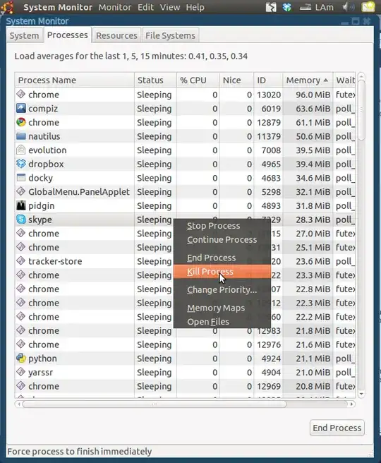

Meanwhile, what you can do when facing this is to kill all the running processes named "skype".
Do this by dropping: killall skype in a terminal or by opening your system monitor (System/Administration/System Monitor) and locate the currently running skype process, right click on it and kill it. Ending the process by using the "End Process" won't result in what you wish.
NOTE: If killall skype in a terminal don't kill the process you will be in the need to do the System Monitor trick.
After that, try again running a new instance of skype and log in.
