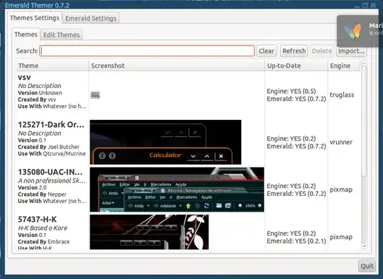

Here is the Emerald theme manager in action:

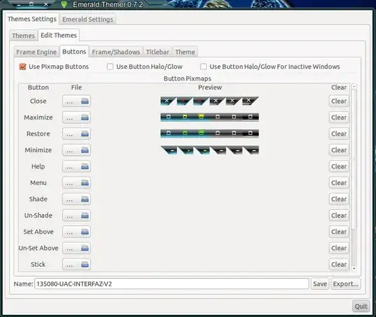

In the next screenshot, I have changed my emerald theme in order to show you how emerald is handling the buttons that I refer (minimize, maximize, close, etc.) And I am showing the "Buttons" Tab inside of the "Edit Themes" section of emerald theme manager.

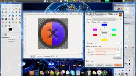

In the next image I have opened the "close.png" png image in order to edit it. I am using the selection tool in gimp in order to change the "hue/lightness and saturation" of the selection to a different color. This tool can be reached in the "Colors" menu of Gimp.
