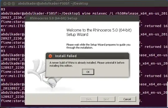

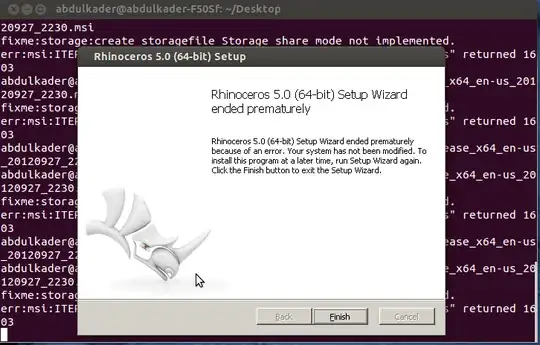

I would do anything to get Rhino 5 working on my Ubuntu 12.04.2 LTS.
First the extension of the file is .msi. I have tried using CrossOver to install it, but failed.
I tried to install it using wine in Terminal:
wine msiexec /i  rh50Release_x64_en-us_20120927_2230.msi
You see I am using Rhino 5 3D 64bit 27.9.2012. It started the installation then showed me this message:
I would do anything to get it working.

The problem, as you know is the msi installer and not the actual program, as it works pretty well in wine (see screenshots below).
You can use several programs to extract msi files, but they all mess up the folder structure and leave cab files which need to be unpacked. The only program that does not do this is lessmsi, which allows you to load up the msi file and select all files to be extracted to a folder. (It must itself be run with wine.) There is still manual setup to be done (see further below), but when the program extracts the files it retains the folder structure specified by the msi installer.
