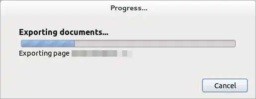

I was trying to use the latest Pencil (version 2.0.3) in Ubuntu 12.04, but the PNG exporting does not work, with Pencil working both inside and outside Firefox (which is 19.0.2).
The export page as PNG dialog asks for where to put the file but fails silently after that, and the export document using any HTML template gets you this dialog stalled forever:
How can I fix it?

UPDATE: Before trying this workaround, you may want to try the latest version provided by this community fork: https://github.com/prikhi/pencil/releases
This is a bug filed several times, and a workaround is available at: http://code.google.com/p/evoluspencil/issues/detail?id=170
The workaround is to use plain xulrunner to run Pencil instead of Firefox, then the problem disappears. You can download xulrunner from here, extract it somewhere and use it to run Pencil like this:
xulrunner --app /usr/share/pencil/application.ini --no-remote
The --no-remote is for xulrunner not to try to reuse an existing Firefox instance running. You may need to change the path to pencil's application.ini, depending how you have it installed.

I ran into the same issue. If you don't mind going down one minor version to 2.0.2 it's packaged with xulrunner as part of the deb, which will resolve this particular issue.
2.0.2_amd64
2.0.2_i386
The Pencil project is on GitHub now https://github.com/prikhi/pencil
Find the latest releases here: https://github.com/prikhi/pencil/releases
Upgrading to the latest (v2.0.13 when writing this) fixed the issue for me.
