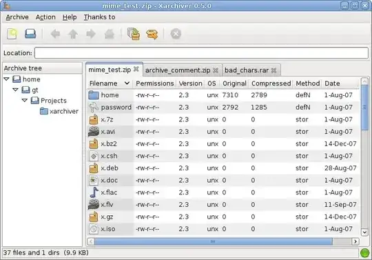

Another good option is Xarchiver
It is a lightweight desktop independent GTK+ frontend for manipulating 7z, arj, bzip2, gzip, rar, tar, zip, rpm and deb files. It allows you to create archives and add, extract, and delete files from them. Password protected archives in the arj, 7z, rar and zip formats are supported.
sudo apt-get install xarchiver
