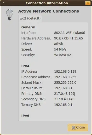

But when I right-click on network manager and click on "connection information" I get:
whois 217.0.43.129 reveals that this belongs to Deutsche Telekom AG, my ISP.
Why does network manager show this information? What DNS server am I currently using?

You are using dnsmasq, a lightweight forwarding DNS server that runs locally under the control of NetworkManager. Dnsmasq forwards DNS queries to the DNS servers whose addresses have been provided by the DHCP server. It is also possible to set these DNS server addresses statically using the Connection Editor.
The dnsmasq executable is provided by the dnsmasq-base package on which the network-manager package depends. There is also a package called simply "dnsmasq" which also depends on dnsmasq-base, but this "dnsmasq" package should only be installed if you want to run dnsmasq independently of NetworkManager in order to take advantage of features other than mere DNS forwarding.

You're using the 217.0.43.129. if both your primary and secondary DNS are not found, it'll go to your router and use the DNS server configured in the router. If that DNS fails as well, it'll probabely try to connect to the openDNS server. as configured in /etc/resolv.conf.
