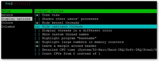

They're not processes, they're threads under one process.
By default htop shows threads and in this case, is very misleading. You can alter this by going into Setup (F2), Display options and checking Hide userland threads.
Press F10 when you're done.
