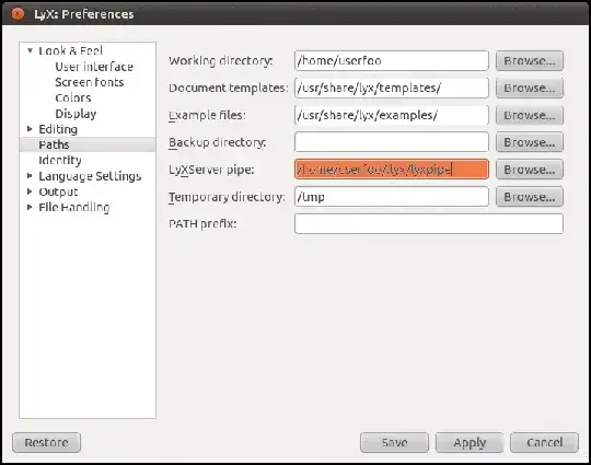

The English version of the LyZ page has some instructions for this, which I assume are the requirements. Here's how to set the path you need :
Go to Tools > Preferences > Paths
In the LyXServer pipe field, enter ~/.lyx/lyxpipe and save.
Here's the preferences screen. You'll want to edit the field highlighted in orange.
After this, restart LyX.
EDIT: Just to state what may not be the obvious - make sure that this path is the same as in the Zotero pane, Lyx dropbown box > Settings... > Lyx Server.
