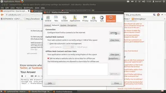

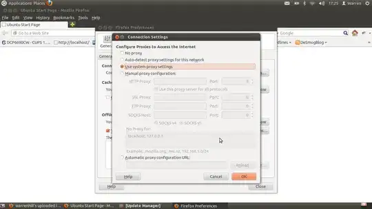

Normally Web browsers such as Firefox take their proxy settings from the system through the http_proxy environment variable but this can be changed from the menu:
"Edit" > "Preferences"
