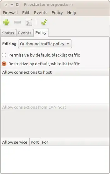

You can use the Firestarter firewall tool to limit your outbound connections to the vpn host. It is very easy to configure, and you can toggle it on and off with a single button click.
To create such a setup, hit the Policy tab, choose Editing Outbound traffic policy, and select Restrictive by default, whitelist traffic. Then you right-click on the empty list below, and add the vpn host to the whitelist.
Firestarter policy editor
