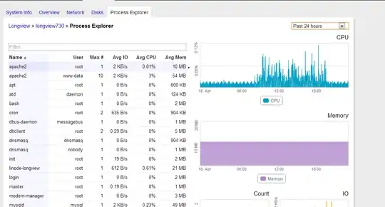

I checked few programs such as htop or top command but couldn't find any features for logging per minute.
Is there a way to do that for tracking memory issues ?
edit: I was using linode and decided to use Longview.
