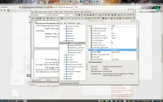

To counter this, you can copy your themes and icons to /usr/share/themes and /usr/share/icons respectively, as well as set the gconf entries for your gtk/icon/metacity themes using gconf-editor to default (sorry I could not capture the menu in my screenshot). (right click the entry, then click set as default)
