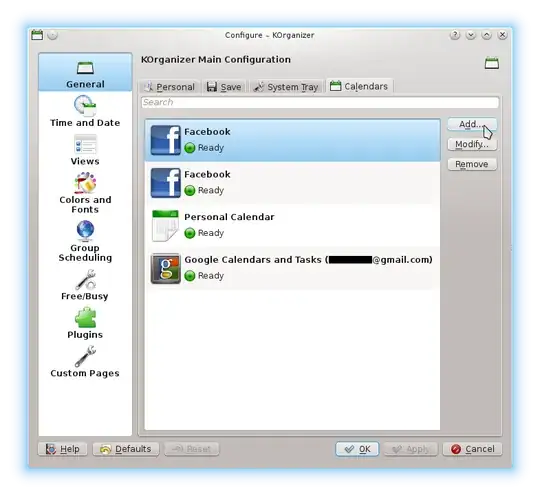

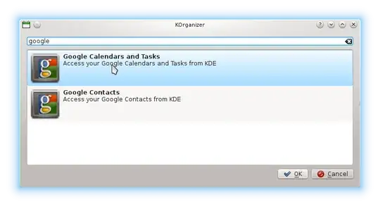

Akonadi (and thus KOrganizer) have direct support for Google Calendar now.
  1. Go to Settings -> Configure KOrganizer Press "General" -> "Calendars" tab -> Add
  2. In Settings: Press "General" -> "Calendars" tab -> Add Press "General" -> "Calendars" tab -> Add
  3. Search for "Google" and press "Google Calendars and Tasks" Search for "Google" and press "Google Calendars and Tasks"
  4. Press "Add" and sign in to your google account

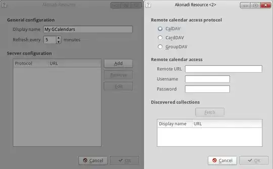

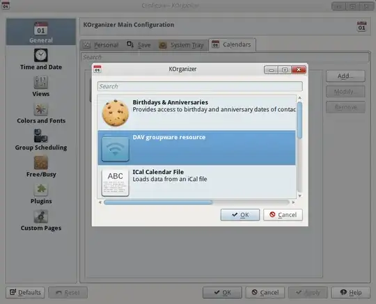

You can do it by :
=> Open KOrganizer and navigate to Calendars (Configure KOrganizer- General- Calendars)

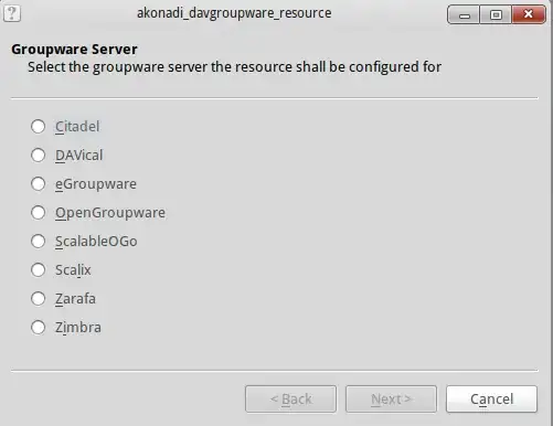

=> Click on ADD Select DAV Groupware Resource
=> Akonadi_davgroupware_resource will popup, click Cancel.
=> Now you will be able to add Akonadi Resource manually.
enter image description here => Under Add server configuration, choose CalDAV. Remote URL format is "https://www.google.com/calendar/dav/Calender_ID/events/ . Personal calendar_id is usually your Gmail Address . you're done.
