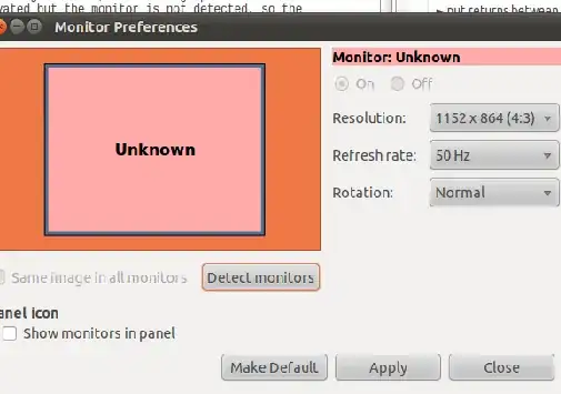

When I go to System>Prefs>Monitors, I get:
It appears that your graphics driver does not support the necessary extensions to use this tool. Do you want to use your graphics driver vendor's tool instead?
YES NO

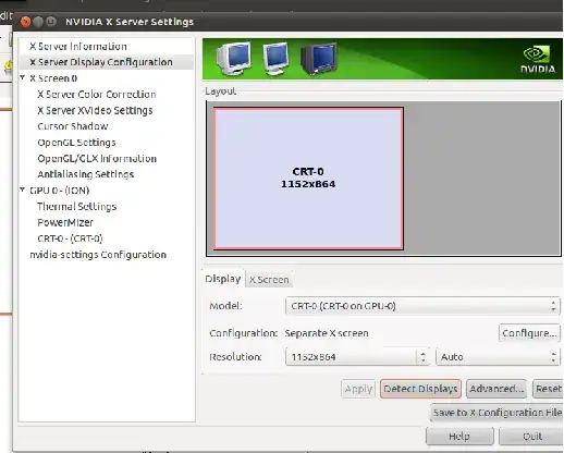

If I say NO then I get a window:
or for YES I get this:
In both cases I don't see that I can fix this problem. The main reason for getting this new computer was that I was sick of having graphics problems on the old one with a very ugly solution that didn't give me hardware support - but at least I got the resultion. Why is this so difficult... sigh!

Now go System > Administration > NVIDIA X Server Settings (open it)
Next select X Server Display Configuration and select your resolution
Then click 'Save to X Configuration File'
Fill in the your admin password to save the file and restart your computer for good measure. If this doesn't work then someone else will adapt my instructions to your needs.
