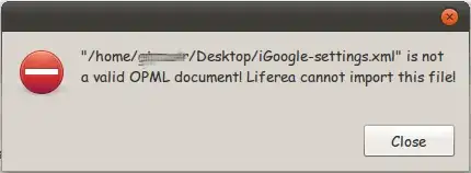

I use igoogle for my rss reader, now i need to use Liferea on my Desktop and i need to Export my iGoogle rss and Import into liferea. I was trying export my rss from iGoogle (The default export format is .xml) but when i tried to import into  Liferea I get this error message
 is there another way to do this?

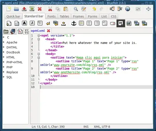

            You can create your own OPML file by following the next procedure:
- Make an empty file and name it "opml.xml" (or whatever you wish but remember to use the ".xml" extension for the file.
- Open the file using your favorite editor. (I prefer the usage of bluefish but you can use gedit for the code recognition and highlighting).
- Write the code as in this example:
 (unfortunately I can't place code here, so I put an image instead but you can gain access to an example of my current opml file in the next link: opml file example
Then save the changes in the file and try to import this file instead of the direct rss xml file (in your case iGoogle-settings.xml)
Things to consider:
- You can add as many xmlUrl's as you wish, one line at once (starting from the "< outline ...")
- xmlUrl must be a valid address. If you are using this example for a "one-time import", you can use local places by using just the file name, in which case both the opml file and the rss source must be placed in the same location.
- I suggest you to try the opml file to get the connection to your web rss feed, in which case you should use the remote address for the xml file.
