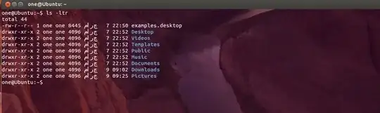

I have installed Ubuntu 13.04 and set my local time/date and its working, the only thing that's bugging me is that I cannot change it to English. I would like to do this because it is hard to read and it is not showing it in the proper format in the Terminal, please refer to the screenshot below.
Show in the proper format
Not showing in proper format in terminal
How can I change my date/time to English format and keep the local time?

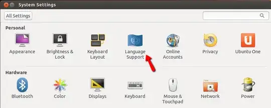

Click on Language Support.
Language Support icon in System Settings

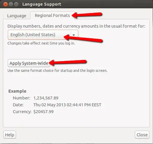

Click on the Regional Formats Tab, and change language to English, and apply system- wide. and that will do it.
Note: You may have to relogin, so changes can take effect
Regional Formats settings

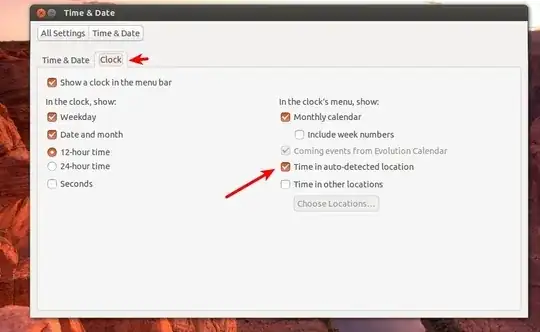

Choose the New York time when installing Ubuntu 13.04, And do the following steps for you local time.
1.Click on settings > Click on Time & Date
It need to me check, By default it will be, if not check it
2.Click on Clock and check Time in auto-detection location
3.Wait few minutes and you will see you local time just above shutdown button
OR
Click on it
Done
