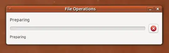

Why is emptying the trash so slow? What is it doing when it says "preparing." How much preparation does it actually take to run rm -rf ~/.local/share/Trash/?

When you "trash" those files it loads the entire tree file into memory and then deletes each file one by one. This allows for timing calculations to know how long it takes to delete the file, how many files are to be deleted, how big those files are, although most of the parameters are not used here, and allows you to press that little red cross to stop the process.
