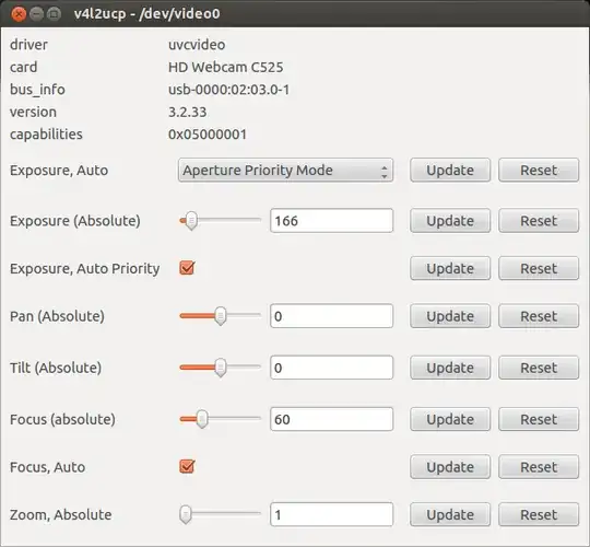

I am using the c525 with OpenCV, and for my application to work properly, I need to disable auto exposure, the exposure automatic priority, and the auto focus.
Default settings from Video4Linux Control Panel: image

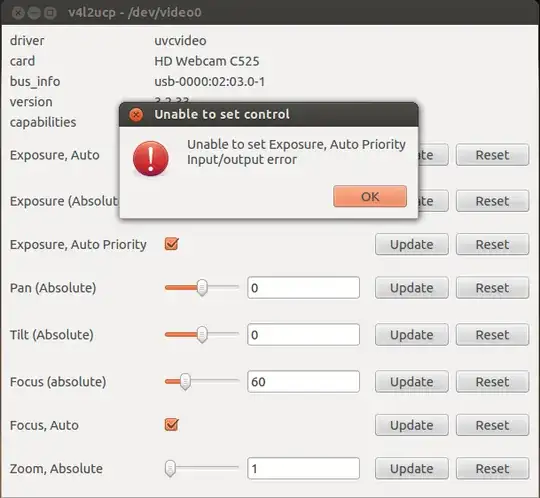

When I try and change exposure auto priority: image

I fiddled with the settings, and was able to change auto exposure priority, but then inside OpenCV, I get a lot of device timeouts.
