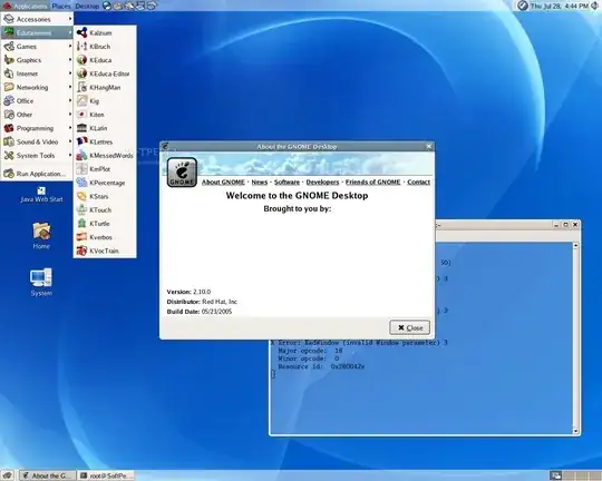

I don't know about the future, but you can try another DE like KDE/Gnome3/LXDE/XFCE. However if you want the look of gnome 2, you can install gnome-panel from software center. Then log out select gnome-classic from session.
It will look something like
http://i1-linux.softpedia-static.com/screenshots/GNOME_2.jpg
This is applicable for Ubuntu 12.04 LTS.

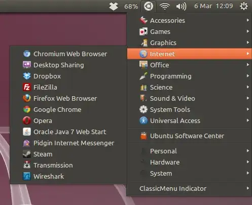

This is probably not going to be part of the official releases, but to me it sounds like the old-style menu is what you mostly miss from pre-Unity Ubuntu? You can get one in Unity too as an indicator menu, without changing the desktop environment:
ClassicMenu Indicator
Open the terminal (Ctrl + Alt + T)
sudo apt-add-repository ppa:diesch/testing
sudo apt-get update
sudo apt-get install classicmenu-indicator
Then open Dash, use the search perhaps for one final time ;), and open ClassicMenu Indicator. It adds itself automatically to the Startup Applications.
