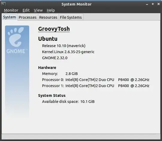

64
It's often overlooked, so worth a shot. Sorry if this is insultingly obvious :
System Preferences
Alt-F2, then gnome-system-monitor
Also, when I ran sudo lshw | grep -i cpu, I see a line which says cpus=2.

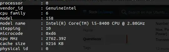

You can just use this : more /proc/cpuinfo in your command line.
Then you faced with something like this :
You can use this for more information :

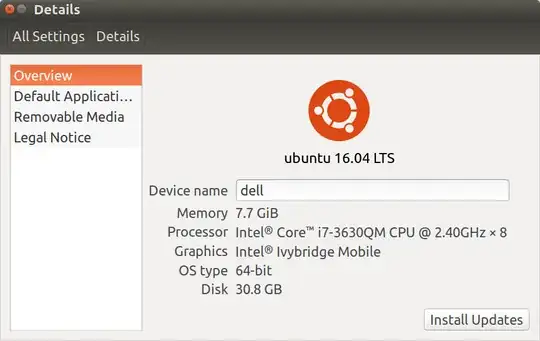

The simplest way is from Launcher select System Settings-->Details:
System Settings About
This identifies both your CPU model number and whether 32-bit or 64-bit software is running. It also displays other useful information such as amount of RAM.

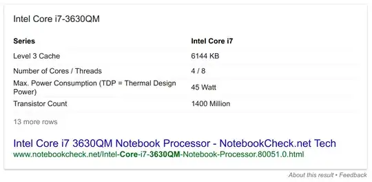

Now take your CPU model number in google search engine type 3630QM number of cores:
Replace 3630QM with the model number you get from the first display.
All the other answers are great answers but if you really want the "simplest" way of doing this I believe this is the preferred method without opening a terminal session or installing new software.
