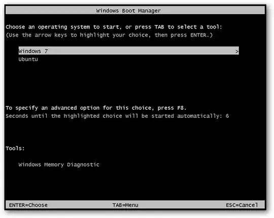

  2. legacy boot image
    After setting up Easy BCD, if you see the above legacy boot image instead of the modern metro boot menu, go to easyBCD and set Windows 8 as default boot OS, save setting, run cmd as administrator and type bcdedit /set {default} bootmenupolicy standard. For details, refer to these links:
  3. If you are having issues with booting into grub (Ubuntu could not find grub2), try go to easyBCD, add a new NewGrub entry, click configure and insert the following:
    title Ubuntu/Linux 13
    find --set-root /boot/grub/i386-pc/core.img
    kernel /boot/grub/i386-pc/core.img
    boot
