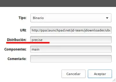

First open Software Properties
  • Software Center>Edit>Software Sources
  • Then go to the Other Software tab and click the Edit button on the PPA you want to edit. enter image description here
  • Change the Distribution name and Accept. Then update your repositories running sudo apt-get update. You should be able to install the package now.
