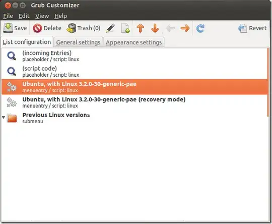

Note: If that cmd not help you then you can use this tool, Grub Customizer. To download, Open terminal and type:
sudo add-apt-repository ppa:danielrichter2007/grub-customizer
Hit Enter
sudo apt-get update
Hit Enter
sudo apt-get install grub-customizer
Hit Enter
Open dash and search grub customizer, and run it. Like picture below, Delete kernel you want to remove and then save.
