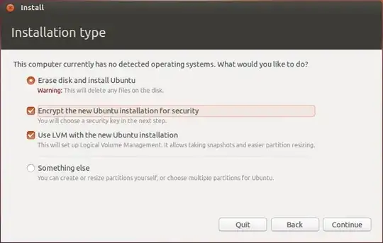

During the installation of Ubuntu, in the Installation Type step you will see a similar window like this:
screenshoot
You have to activate the Encrypt the new Ubuntu installation for Security option. Then Ubuntu will choice the encryption type automatically.
