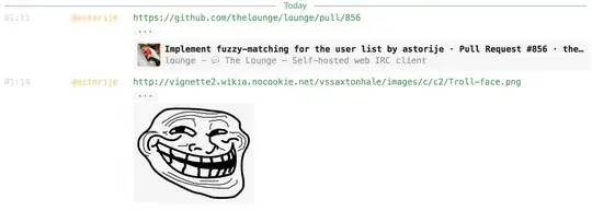

The Lounge will let you do that through its link prefetching mechanism. For the record, link previews currently look like this: Link prefetching of The Lounge

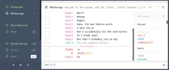

This screenshot is part of the whole app, which looks like this:enter image description here
FYI, the author from Subway (mentioned in the other answer) now recommends to use The Lounge.
