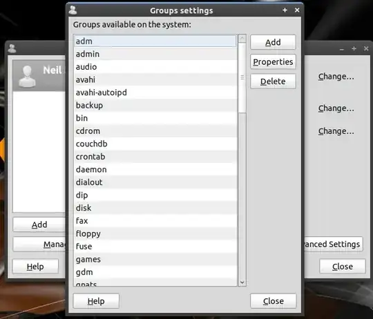

I know that some define permissions on the file system (such as www-data). But I don't understand why this question was answered successfully by adding a user to the "Video" group.
So the question is mainly what do all the pre-built groups do in Ubuntu? More reasonably, since there are so many, what "special" groups exist and how or when should they be used?
