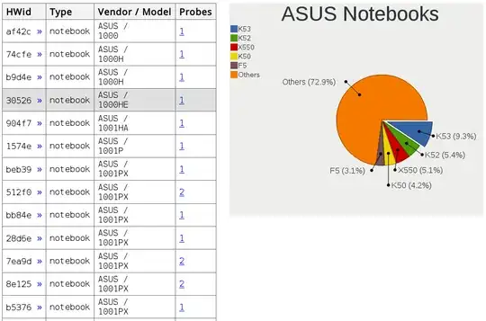

A tool to collect and store hardware info of your computers: https://github.com/linuxhw/hw-probe
You need to run one simple command to check and upload computers hardware:
sudo -E hw-probe -all -upload
It will return a link like this to discover your hardware specs, logs, SMART-reports for hard drives and more.
You can also get the inventory id to see your personal list of computers on the site: https://github.com/linuxhw/hw-probe#inventory
Also you can download your collection of probes for offline use (do not rely on the web site availability): https://github.com/linuxhw/hw-probe#offline-view
I'm the author of this project, feel free to ask any questions in comments!
