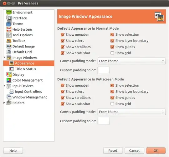

You would need to change the settings through Preferences Window instead of View Menu. Changes made through View Menu are not persistent, they get overwritten when you restart GIMP.
  • Open the Preferences Window by navigating through Edit Menu → Preferences.
  • Then in the sidebar navigate through Image WindowsAppearance.
  • Here, tick/untick the appropriate check-boxes as per your preference.
GIMP Preference Window
