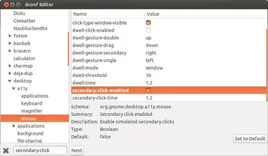

Ubuntu 12.10 and 13.04
Ubuntu supports two-finger right click on multitouch pads, but there’s no much options in Mouse/Touchpad Settings (due to GNOME changes). However it’s possible to activate secondary click by holding down primary button through Dconf Editor which is pre-installed in Ubuntu 12.10 and 13.04. So:
  1. open Dconf Editor by searching in Dash;
  2. go to org > gnome > desktop > a11y > mouse;
  3. check secondary-click-enabled;
Secondary Click by Holding Down Primary Button
As seen in the screenshot, it’s possible to set the time of long click as well.
