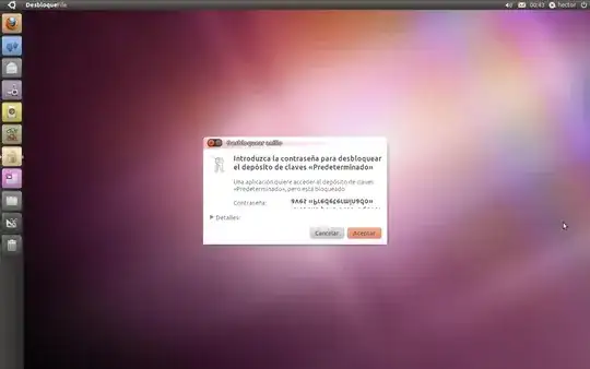

I Love the unity interface... so I installed the interface in my desktop pc and I installed the Ati Official Drivers, I recently Bought an Ati HD 4350, and the interface starts but very Sluggish and when I open an app, it just frezees constanly, even the title bars from the windows look distorsionated.

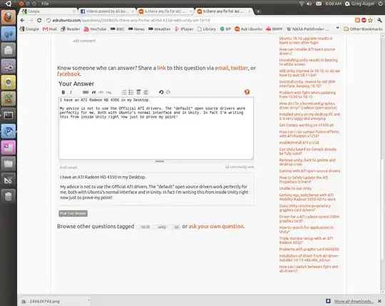

I have an ATI Radeon HD 4350 in my Desktop.
My advice is not to use the Official ATI drivers. The "default" open source drivers work perfectly for me, both with Ubuntu's normal interface and in Unity. Unity is not sluggish, does not freeze, or have corruption of the window borders for me.
To deactivate the Official ATI drivers you need to go to System->Administration->Additional Drivers (but if you installed them using some other method, you may have to do uninstall them differently).
