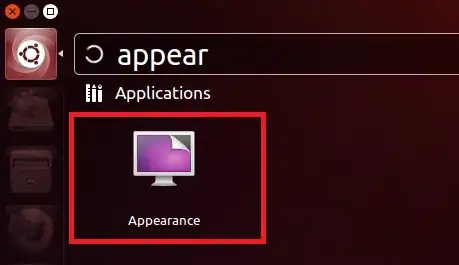

Workspaces are disabled by default in Ubuntu since 13.04. To enable them, open Appearance from the dash:

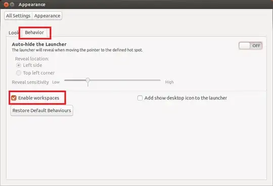

Switch to the behaviour tab and check "Enable Workspaces".

Ubuntu 13.04 Raring Ringtail will come with workspaces disabled by default, so before being able to switch between them go to "System Settings..." > "Appearance" and switch to "Behavior" tab, then it is just to check "Enable Workspaces" option and you will have back your 4 workspaces.
