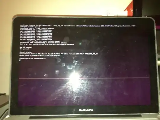

When I try to boot OS X I get this:
http://i1084.photobucket.com/albums/j404/ryebread761/image_zpsdb83a7d9.jpg

Quick Update: I have successfully booted OS X 10.8! I held option when starting, selected my OS X hard drive and from there it started rEFIt. I selected OS X and it booted as normal! Now I just need Ubuntu to work correctly.
Update 2: rEFIt now appears on startup, and the only issues is the Ubuntu graphics. If I can get unity to start correctly, and all the graphics to be displayed nicely, I'll be good. Yay, progress!

Your grub configuration is wrong, I actualy just fixed this on my macbook pro. In grub configureation, /boot/grub/grub.cfg, delete the menu entries for "Mac OS X (64-bit) and (64-bit) but copy your uuid (where it says search --no-floppy --fs-uuid --set=root youruuidhere) and just put this:
menuentry "Mac OS X (32-bit)" --class osx --class darwin --class os {
    insmod part_gpt
    insmod hfsplus
    set root='(hd0,gpt3)'
        load_video
    chainloader /usr/standalone/i386/boot.efi
    boot
menuentry "Mac OS X (64-bit)" --class osx --class darwin --class os {
    insmod part_gpt
    insmod hfsplus
        load_video
    chainloader /System/Library/CoreServices/boot.efi
    boot
This method just dumps the grub bootloader into the efi component of the mac operating system instead of trying to load the xnu kernel manually with the kernel extentions. Grubs way of booting mac has never worked for me so i just use apples way of booting. Hope this works for you too.
