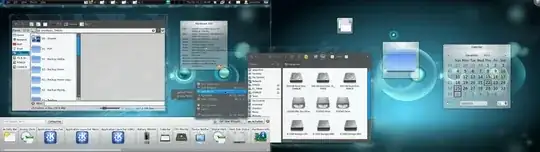

My desktop looks like this:

NOTE: I am using emerald theme manager with the "tron legacy" theme installed in order to decorate my desktop.
I personally don't find these widgets useful but it looks awesome. I must warn you that you will need lots of RAM in order to manage both desktops at once, my 4GB DDR667 is doing a great work but it takes 75% of the RAM when both desktops are opened with just a few gadgets, nautilus and dolphin working, a web browser, chat and a terminal. Just for your consideration.
