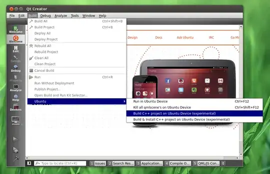

  5. Go to Tools > Ubuntu > Device > Enable > Cpp compiling on Ubuntu device (experimental)
Then start hacking:
  1. Open your app's project in Qt Creator
  2. Go to Build > Ubuntu > Build C++ project on Ubuntu device (experimental)
Building C++ Touch projects on the device
And off you go! :-)
