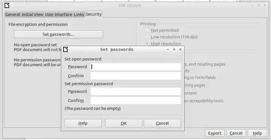

If you use LibreOffice and export a document as PDF (Menu > File > Export as PDF), there's the option to set a password:
21
