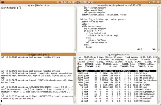

Try Terminator. It allows you to split the terminal window (You can also have tabs and separate windows).
simple terminator usage
You can install terminator from your current terminal with this command:
sudo apt-get install terminator
Or you can search 'terminator' in Ubuntu Software Centre (or Synaptic).
