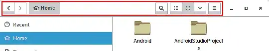

Files Top Menu
This is my menu in the Files app. Note I don't have any menu like "Edit -> Preferences" as others have shown elsewhere.

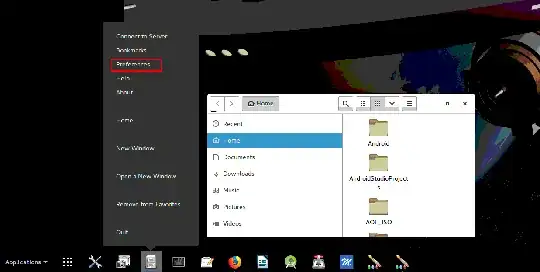

RightClickFilesIcon
When Files is open you can right (outside) click its icon in the panel to open "Preferences".

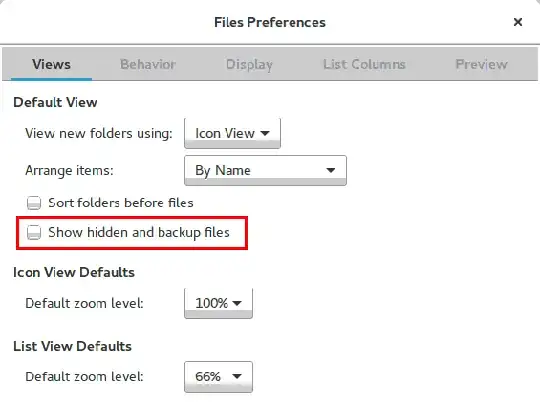

Files Preferences Window
Now when I go to the "Views" tab I can see "Show hidden and backup files". At this point my answer should be the same as shown elsewhere. It's just a matter of understanding that not everyone has the same desktop or Ubuntu version.
